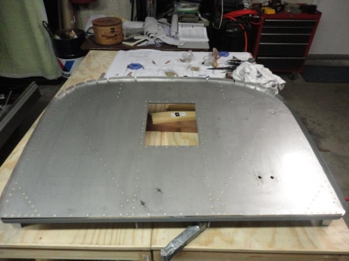

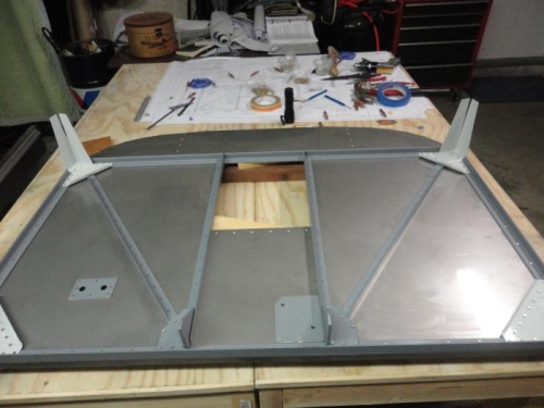

I worked most of the day and finished the firewall. I threw the rivet tape in the trash can. Masking tape is easier and better. I am a little frustrated with F-601J angles. Keeping edge distances and ending up with rivets
that have to be shot with a modified back rivet tool the results are not pretty. It looks like they will be adequate however. The firewall recess will be riveted later to allow access.
