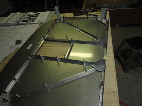

I match drilled all the doublers and gussets. Fabricated 601p's and 601E.

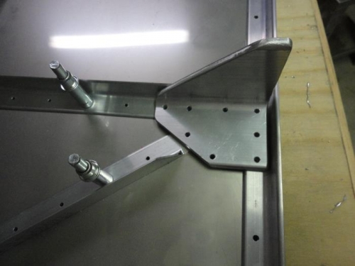

I drilled 601J's and I do not like the hole placement but this seems to be
the normal outcome. Edge distances are OK but rivets will be right up against the inside radius of the angle.
601J
