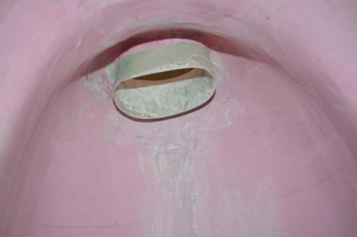

Brief Description:  filtered air box
I assembled the air box and carb. heat control. I extended the chin scoop per the plans. I glued in the foam block shaped it to the inside of the scoop. I put in the strips of glass and held them in place with a balloon. I still need a little more glass work with micro ballons the I should be able to
sand to final shape
Air box with carb heat
chin scoop after initial glass
