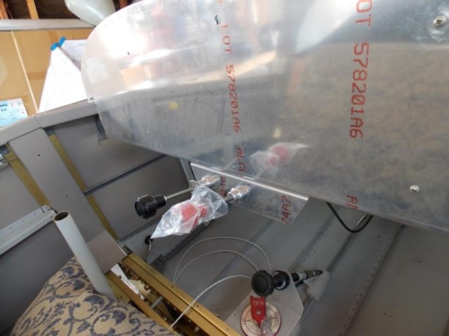

Brief Description:  control cables, canopy fairing
It seems that very little was accopmplished for this amount of time spent. I gathered the hardware for the mixture control. There is a special bushing that goes into control arm. Hard to find in inventory. After mounting the cotrol cables I found that the throttle cable was too short. I verified the part then called Vans. Ken informed me that they get this same call about three times a week.
I had installed the control bracket backwards. Well. I guess I am in good company! Moving on I did some more work on the cowl hinges. I also wanted to do more on the canopy fairing and the line at the plexi is starting to take a much better shape.
Wrong! bracket should not be flush with the panel
The fairing line starting to take shape
