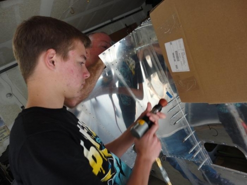

Worked with Jake today on the left outboard lower wing skins. I had a hard time keeping the bucking bar straight. A couple of new smileys were
added today. The rest of the skin should go better since the rib flanges are facing outboard. I will be able to see the shop head being formed. About half the rivets today had to be done by feel. This cost me time and the smileys.
Jake with the rivet gun
