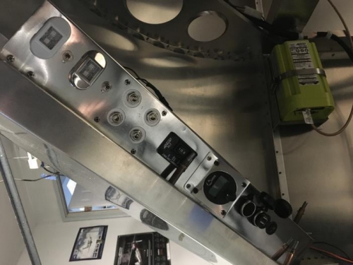

ELT tested
ELT tested using 121.5 frequency on a hand-held radio 30 feet away. Tested the test switch on the unit and also on the remote panel mounted switch.
Had to organize with a friend during the first 5 minutes of the hour. Only held each switch for 15 - 30 seconds.
