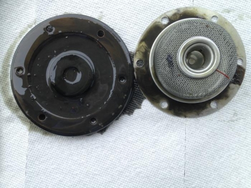

The manual calls for an oil chang after 5 hours. The airplane has not flown yet but the engin has been run for tuning and testing and during taxi testing.
There was very little metal shavings (more like specks) in the oil residue on the sump plate. The screen had no blockage. I did find a few slivers of Red RTV. I felt there was no reason to worry based on what I found.
