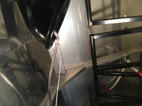

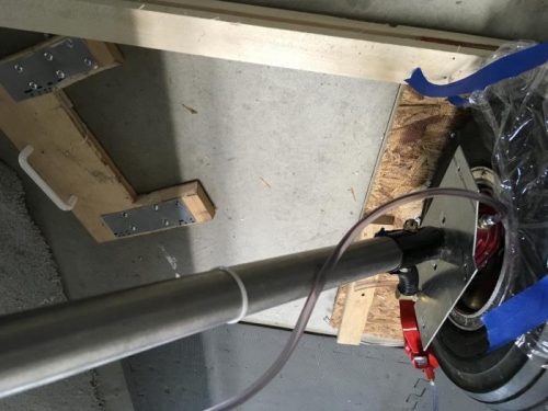

I researched a technique online which connected tubing that ran from the bleeder valve all the way back to the resevoir. so on 10/04/2018 we setup and implemented the new process.

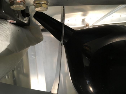

Once the tubing filled with fluid then by applying brake pressure the fluid flowed all the way from the master cyinder to the resevoir snd air bubbles were pushed out while refilling the resevoir with each application of braking.
Also note that one person applies breakes while the other simaltaneously opens the bleeder valve. This allows fluid and bubles to pass throug the system. Do not release brake pressure while the leeder valve is open. Once closed the then the process can be repeated again and again untill all the air is removed.
I made a holer for the funnel fromsome scrape sheet metal so that I could have a hands free system for routing fluid into the resevior.
