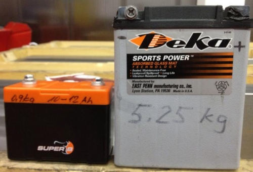

Lightweight Lithium Ion starter battery, 1.98 lb / 900 gram,
This newly developed battery is designed to replace the much heavier 10 to 12 Ah lead/acid battery. The super B 5200 is based on the safe Lithium Iron Phosphate technology (LiFePO4), better known as Lithium Ion.
The super B 5200 delivers up to 300 Cranking Amps.
The super B 5200 offers many advantages over conventional 10 to 12 Ah lead/acid batteries:
Weighs less: as much as 80% weight saving; 1.98 lb / 900 grams;
Recharges many times faster: within 5 minutes after starting your engine the battery will be recharged;
Is much smaller: 1/3 or less of the space; 4.49 inch, 3.2 inch, 2.4 inch (WxHxD) / 114mm x 81.25mm x 62mm (WxHxD);
Has a longer service life: more than 5 years instead of 2 to 3 years;
Has a low self-discharge rate.
Safety: Super B batteries are based on Lithium Iron Phosphate technology (LiFePO4). This so called Lithium Ion technology as used in the super B batteries is the safest Lithium Ion technology today.
Capacity
super B 5200 refers to 5.2 Ah (Amps/Hour), which represents the real nominal capacity under maximum continuous load. How different this is from lead / acid batteries where manufactures provide a 20 hour rating. For example the 10 Ah lead / acid batterie can be discharged over a period of 20 hours with a 0.5 Amp load. This is not very practical, as the same 10 Ah battery discharged with a 2,5 Amp load, for example a 25 Watt light bulb, will yield no more than 2.2 Ah of energy. The lead-acid battery, therefore, has less capacity when the load increases, which means that you can start more often with the super B.

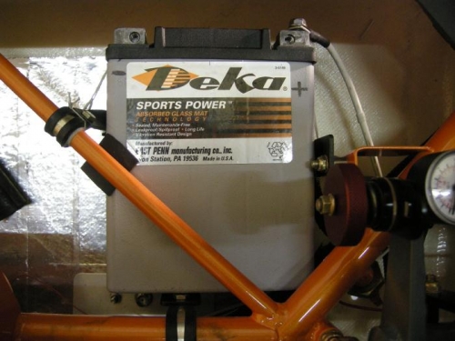

Before
Before

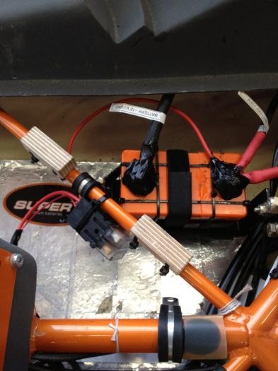

After
After
