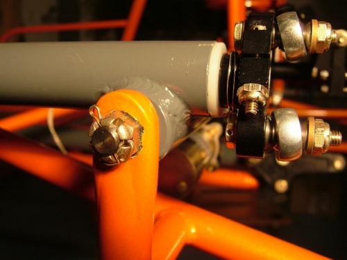

These two bolts are turning with the collective.These nuts originally are metal self locking types. To be on the safe side I replaced them with castle nuts, drilled a hole and used a safety pin.
