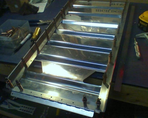

Date:  5-27-2012
Number of Hours:  4.50
Manual Reference:  Ch. 8
Brief Description:  Front seatback
Clecoed all parts together and matchdrilled all holes and then the usual process, uncleco, disassemble, debur, smooth, reassemble recleco and rivet. I bent the end of the hinge pin at a 90' angle. It will be easy to remove if need be. Looks good , now for the back seat, that looks a bit more complicated.

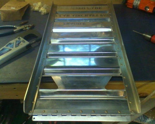

These came out nice, practice for my taxi light holes.
Finished
Finished
