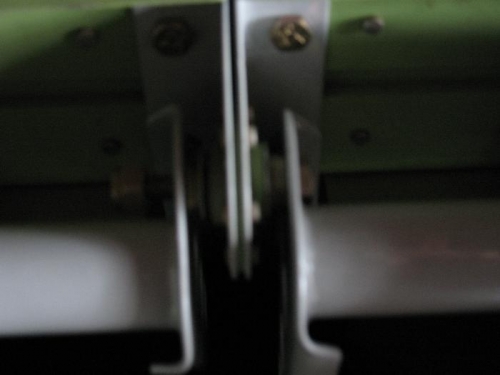

Brief Description:  Adj. Elevators Drill El. horns
Removed elevators , again. Had slight rubbing in right elev. Adj. hinge bearings all to 27/32" , specs call for 26-28. Drilled elevator horns for bearing bolt It took me 1.5 hours of fiddling around to get the bolt 8 washers and nut in place , and I thought the elevator hinges were a bitch.
