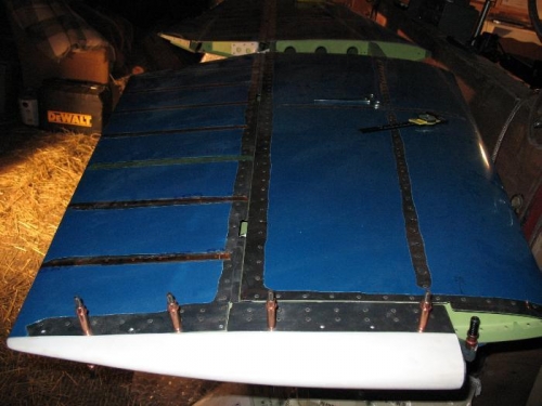

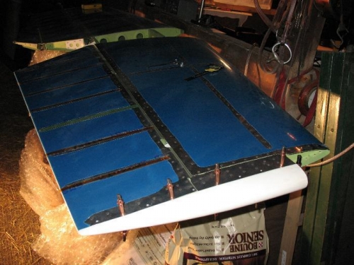

Date:  9-21-2008
Number of Hours:  3.00
Manual Reference:  Ch. 6
Brief Description:  Cap/ Attach elevator to H.Stab.
Match drilled and clecoed tips. I'm going to wait until I drill and connect the elevator horns incase I need to remove more lead than I expect. I believe this elevator is a little lighter than the trim tabbed side. Drilled and dimpled holes for counterweight bolts Note, lube the bit well when drilling the lead and let it cool or you will get what looks like an ant hill made of molten lead surrounding your drill bit that takes you ten minutes to get off. Countersunk holes in lead to match skin and attached bolts and locknuts. Cut skin on H.Stab for elevator clearance and installed elevator. I then took them off put them on took them off put them on. I want all my distances to be within 1/32 ".
