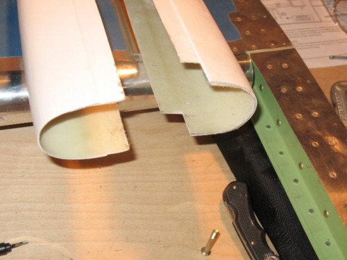

Brief Description:  Counter weight/End cap

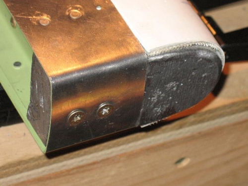

Cut and trimmed fiberglass end cap for left elevator . Grinded and fitted counter weight , also drilled and machine countersunk holes in weight to match skin that I also counter sunk for the bolts . Bolted in weights and the whole thing looks pretty good but I will still have to grind a little more off the weight around where the tip overlaps so it will sit more flush beforeI blind riniting wit the 4-4's. I'll have abetter idea once I match drill the end cap and cleco it all up.
Ground on the wheel
Ground on the wheel
Biggest dimple die I had
A few more final touches
