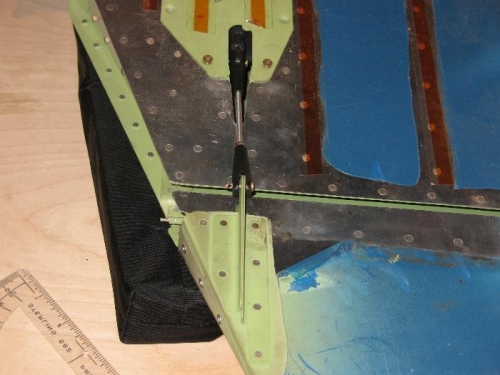

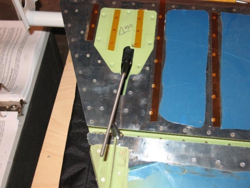

Brief Description:  Trim Servo
Attached trim servo to cover plate. Attached battery to servo motor and fully extende servo, without that brass screw on the back fully retacted into the servo body you cant fit the servo cover plate with servo into the well . Cut the s.s. pushrod , cleaned up threads and installed . My second call to Vans tech. support. 2
