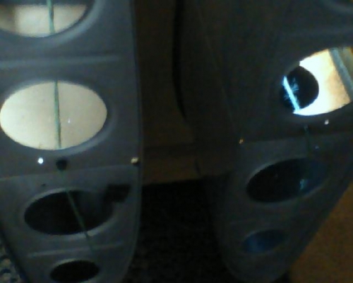

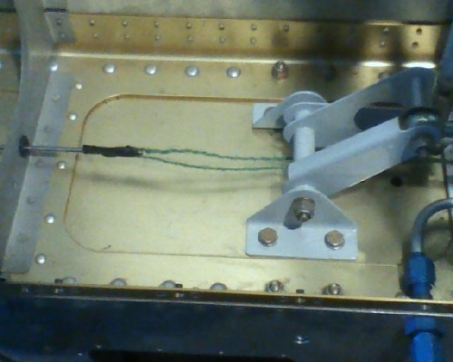

Drilled holes in ribs for snap bushings and after deburring the holes and inserting rhe bushings I ran a couple of strings through each wing. I taped a 12' or so drill bit to the string which helped alot with the root ribs so close and unaccessable. Once I get my lights and other wired things installed this should be a breeze.
taped to extension bit
ready for lights
ready for lights
