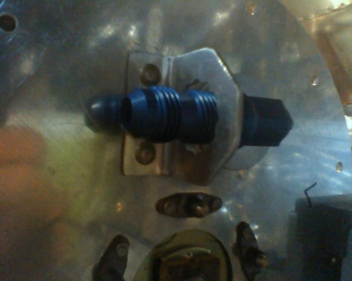

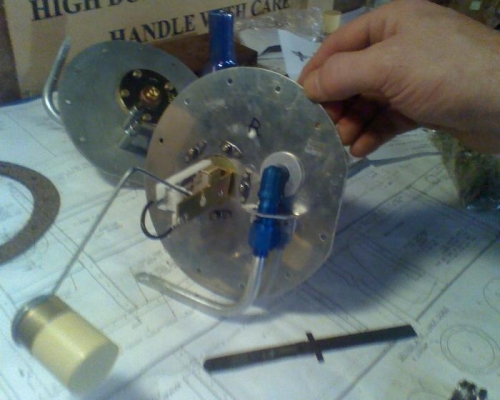

Riveted anti rotation brackets on and assembled pick up tube assy. Installed fuel sending units and adjusted floats to specs As far as final sealing, I will do that later. Vans builder support suggested I not install the gaskets on either the access plate or the fuel sending units and just use tank sealant. I'll have to investigate that further.
fuel sender installed and adjusted
