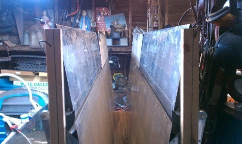

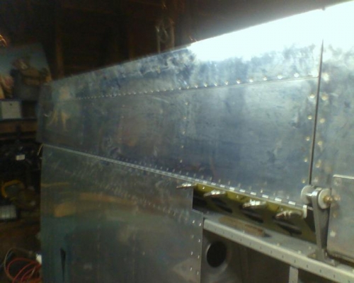

First I removed the hinge pin, then the flap and deburred the flap hinge. I then deburred the back side of the flap brace and clecoed the hinge back on . After a rivet or two my Brown Tool phneumatic squeezer wouldn't squeeze . Oiled it, fiddled here and there ????? So after hand squeezing the rest of them it was time for the fun part. First I put a point on the end of the pin and then oiled it. Next time I am going to only oil the section I'm working on and of course I realized I could bend the pin end 90 degrees and tap it after an hour of twisting. I drilled a hole in the inside aileron bracket and bent the pin so it sprang into position when placed in the hole.
Going no place now
Going no place now
One more to go
One more to go
