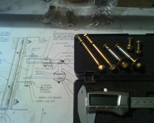

Brief Description:  Bell crank assembly

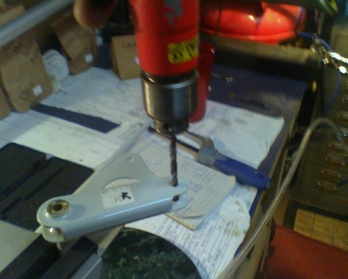

Assembled all the nuts, bolts, washers and spacers that I cut to specs and fit. I cut the spacers a little long then squared them on the disc of my belt sander. To smooth off the ends I placed the spacer in the drill press ( Not to tightly ) and used a 3M scotchbrite pad. All the holes in the bellcrank had to be drilled out .
Nothing fits
