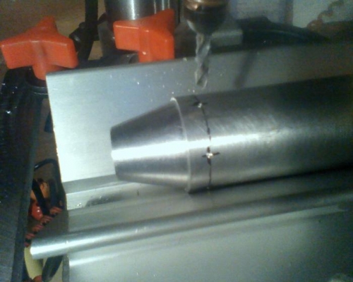

Brief Description:  Pushrods, Bellcrank to stick

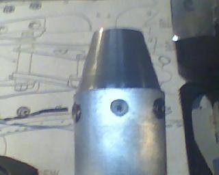

I used 3 Cherrymax blind rivets of the six on each side for a little margin of extra strength. I will powder coat them white to match the 1/2 "steel airleron to bellcrank that comes pre powder coated from Vans. Any corrosion will be very apparent on white. The inside of the tubes were primed with Zinc primer.
Cherrymax rivet
Cherrymax rivet

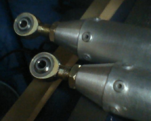

Ready for powder coating.
