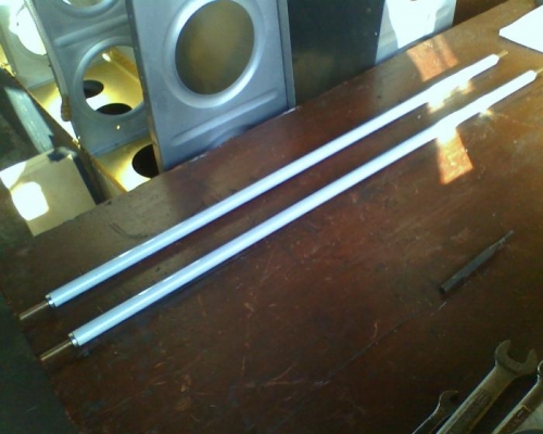

Brief Description:  Pushrod , bell crank to airleron

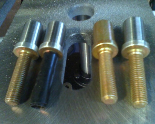

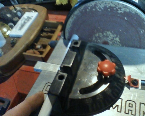

Cut pushrods to specs. I cut them 1/16" over then sanded to length on my belt sander wheel to get everything square. The tube inside diameter is .424" and the rod end attachments are .428" so I had to put tape on the threads, place them in my drill press and took off 5/1000 th of an inch off with a fine flat file and 3100 rpm and they all fit perfectly.
No thread damage

Now drill and rivet.
