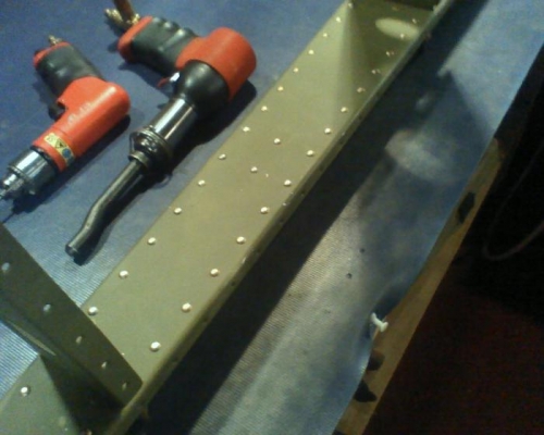

Brief Description:  Vertical stabilizer
Back riveted all flush rivets. completed rear spar riveting along with hinges using the squeezer. It was easier to use the gun and bucking bar for the ribs and front spar assembly. I had forgot the lower nose rib had to be riveted with the base rib at the same time so I got some rivet removal practice.
