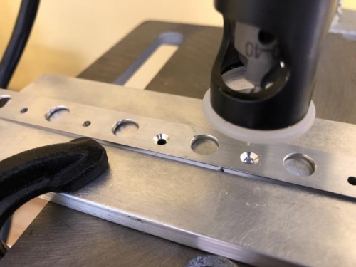

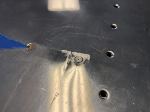

Back riveted stiffeners to rudder skins. Damaged right skin when back rivet plate slipped from underneath. Repaired and re-dimpled skin and stiffener and continue to build. Countersunk rudder trailing edge wedge using using drill press and jig purchased from Cleaveland Tools. I really like this jig and worth the money for me.
The ugly repair of an ugly accident.

Countersinking rudder TE wedge
