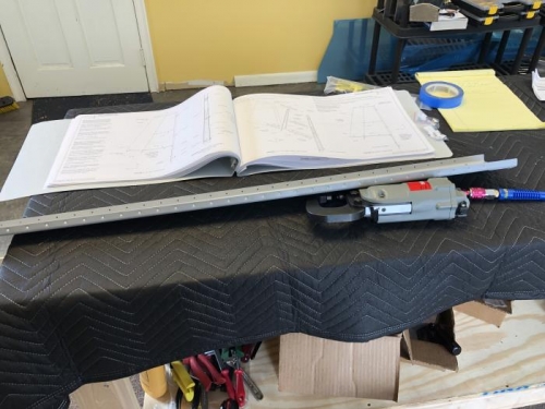

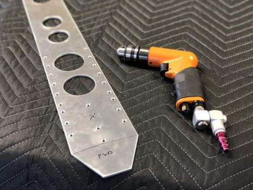

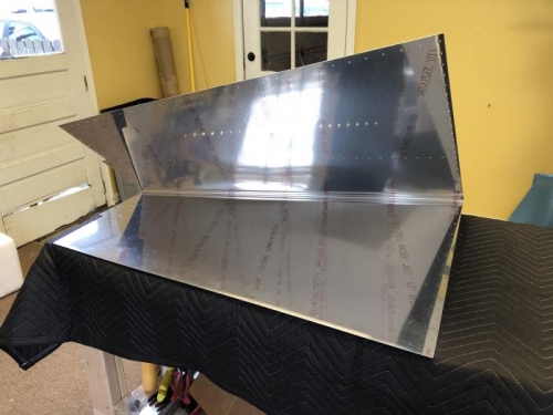

Dimpled completed FWD VS spar, completing a test of the SEM rattle can self-etching primer I've been planning on using. Primer held up quite well. Continued to debur all holes and edges of all components of VS assembly. Countersunk rear VS spar doubler to fit an AN424 AD4 flush rivet. First time countersinking on kit material.
Dimpled primed FWD VS spar
lots of holes to debur in the VS skin
