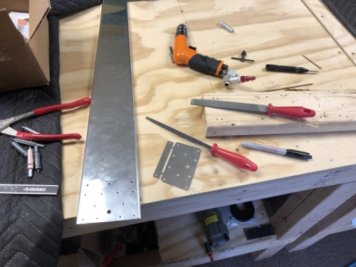

Drilling and trimming of VS spar and doubler.

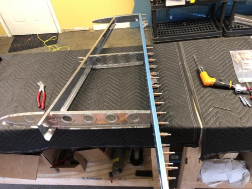

VS assembly clecoed together.

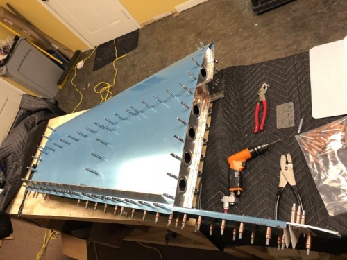

Assembly with skin on and final/match drilling complete.
