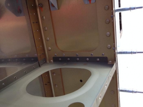

Brief Description:  Left leading edge assembly riveted to main spar
The left leading edge assembly was riveted to the main spar first by using blind rivets to attach the aft flanges of the inner ribs to the main spar. Then the accessible outer ribs were attached with standard AN470 rivets. Once the internal rib flanges were riveted the spanwise rwo of rivets were squeezed both on the top and bottom.
