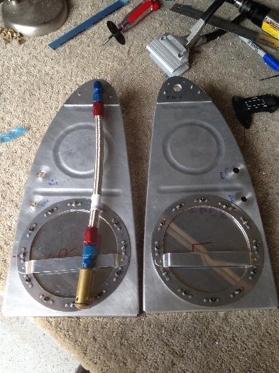

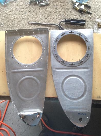

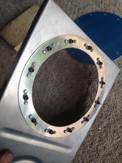

Brief Description:  Access holes on the inboard tank ribs
The inboard ribs of the fuel tank have an access panel. Each inboard rib access hole was cut using a fly cutter. This is my first experience using a fly cutter and there was a definite learning curve. I won't go into detail but if anyone is reading this, do it at very low RPM. After changing my underwear I was successful at cutting both access cover holes.
