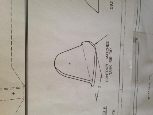

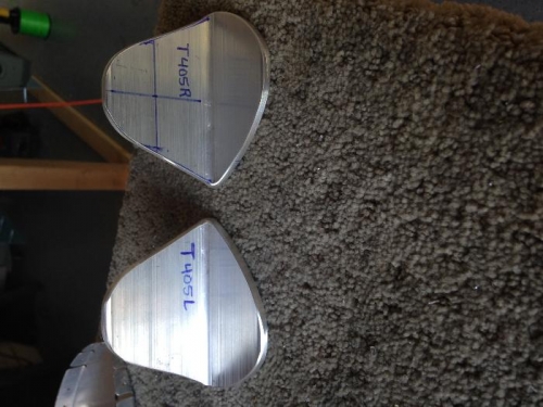

I also started work on the forward fuel tank attach brackets. Each bracket had to be formed out of a piece of angle iron. Once formed, the rivet pattern was drilled onto the forward part of the most inboard rib. Using a hole saw, I cut a 9/16th inch hole into the bracket. This is where the fuel line will enter the tank and attach to the flop tube.
