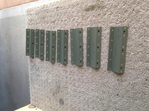

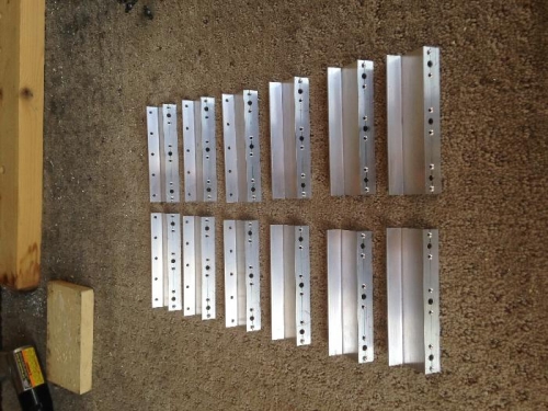

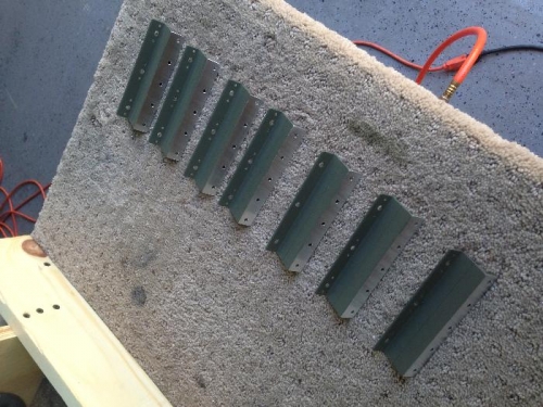

Brief Description:  Z Bracket platenuts
I took the week off and went up to Sun Valley, Idaho for some down time. Now that I'm back, I can start to tackle the wing tanks again. I drilled out all the platenut attach holes onto the Z brackets. Deburred everything, scuffed and cleaned them, and then primed the z brackets except for the flange that will attach to the rear baffle of the fuel tank. I dont want anything interfering with the proseal. Once everyting was dry I Riveted all the platenuts to the z brackets.
