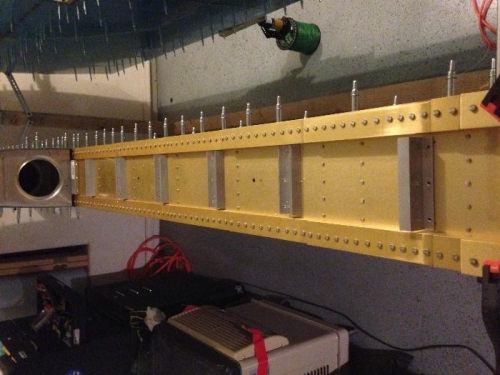

Brief Description:  Preparing the fuel tank Z-Brackets part 2
Took some time off from building to get my hours at the Fire Department out of the way as well as flew a Shanghai trip. When I got back the new Z-Brackets had arrived. I spent today marking a line 1/16" from the center line of each flange that mates with the spar. On the most inboard bracket, I moved the hole 1/16" from center away from the web. The rest of the 6 brackets I moved the line 1/16" from center toward the web. The inboard bracket was done this way so that I could get a socket on the bolt head. The other ones were moved the other way so that the rivet puller would have easier access. All edge distances were verified. The right wing is all I had time for today.
Right wing Z-brackets match drilled
