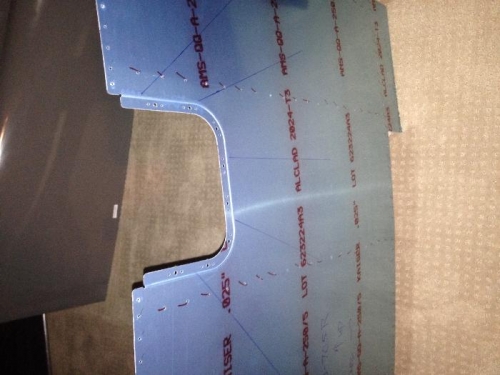

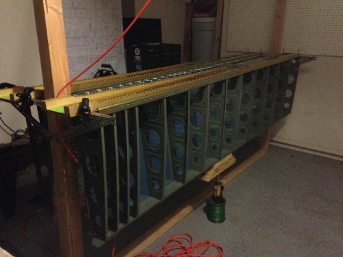

I finished clecoing the bottom skins onto the right wing and match drilled all the holes for the main wing skins. At each wind tie down I drew lines extending from the center of the hole onto the main wing skins. This will enable me to later find the tie down hole once it is covered up by extending those lines to an intersection. Hopefully : ) The leading edge cradles were constructed in preperation for the next steps.
Both wings match drilled and the bottom skins removed so that I can access everything for wiring, etc.
Reference lines drawn on the main skins extending from the wing tie down holes.
