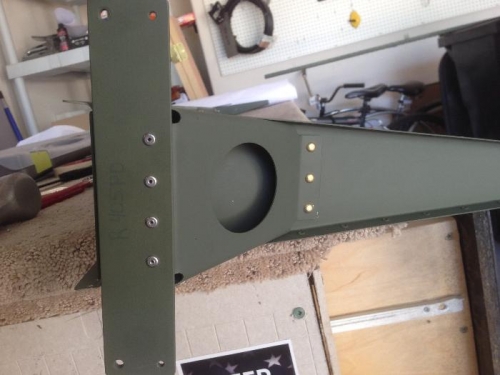

Brief Description:  Riveting the rudder

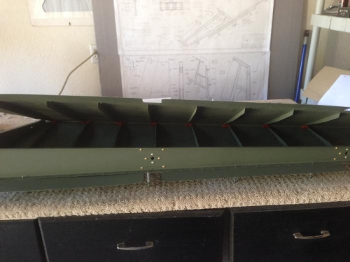

R-713 was riveted to R-703. The two holes in the forward web of R-703 was enlarged to accomodate the bolts that will attach E-614-020. R-703, R-704, R-405PD, R-606PP, R607PP, R-608PP and R-717 were all riveted to R-802PP. Then R-710 was riveted to R-405PD then to R-704. The bottom skin was then clecoed to the rudder structure and a small amount of RTV was applied to the end of each rudder stiffener before the top skin was clecoed to the rudder skeleton.
RTV applied to the trailing edge of each rudder stiffener
