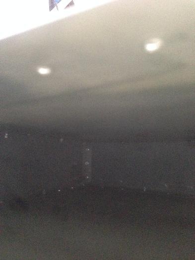

Brief Description:  Riveting the left horizontal stab
