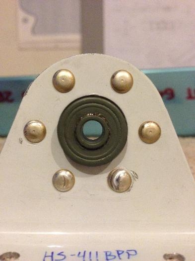

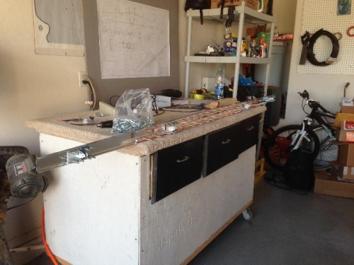

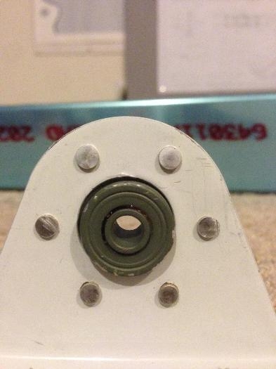

Brief Description:  Elevator Hinge Brackets
Cleco'ed the elevator hinge brackets and drilled them out to final size. After that I Cleco'ed, clamped, and drilled the HS-411PP and HS-411BPP brackets around the VA-146 bearing. All parts were removed, prepped, and the VA-146 bearing primed. Once the primer was dry it was all riveted together. These are the first rivets!!!!!! The bad rivet you see in the picture was drilled out and replaced :/ Im not perfect.
