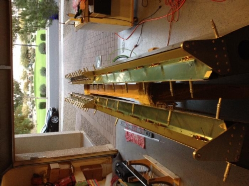

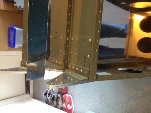

Today I started out by assembling the inboard and outboard aileron hinges. Once everything was in place I match drilled the hinges. They were taken apart, deburred, primed, and then final riveted to the rear spar. I was able to get to most of the rivets with the squeezer.
Once the hinges were riveted, I trimmed the flap fairing and then match drilled both the flap gap fairing as well as the aileron gap fairing.
