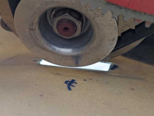

Brief Description:  Making space for the alternator fan
There was an irritant that I had to clear off my head. When using the proper belt and tensioning it, the fan in the front end of the alternator had only a 1/8" clearance. I bought a belt that was 1" shorter, because there was nothing in between and I could not put it on. It was too short. And I also know that once the engine starts, the vibration will make the alternator fan and the cowling kiss ! I think this happens because I am using a 360 engine instead of a 320.

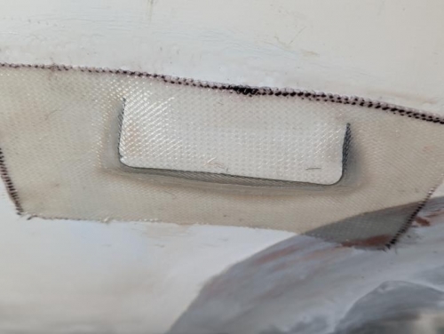

I had to provide more clearance. So, I cut the cowling at the proper location on 3 sides and then heat the left uncut side to reform it so it provides an additional 1/4" to 3/8" clearance under the alternator fan.

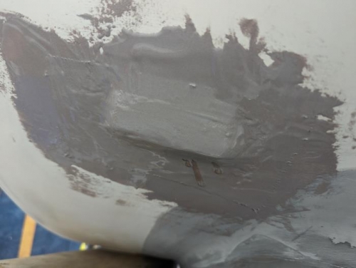

Then I fiberglass that new shape from the outside first, then from the inside and finally I made an epoxy fairing filler microballoons for the finishing side. I still need to sand it but at least it is done. It has a nice enough shape and I think once sanded , it will be perfect. The good thing is the clearance under the fan is far more than sufficient.

Cut , folded & fiberglassed

Finish before sanding
