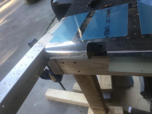

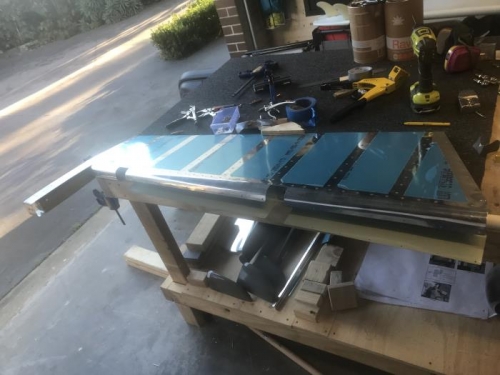

Brief Description:  Leading edge bends
After doing the bends on the rudder and not particularly well in places, I wasn't looking forward to the elevator leading edge bends but after a bit more internet research and my own flavour I have finished just over half of the right elevator.
This time I still stuck with 1 inch dowel but this time used two vice grips/mole grips and also tied a cord to each end so that I could use body weight to keep downwards pressure on the bend to avoid creasing near the spar. Seem to have worked out pretty well so far but not yet qualifying for being a fun activity.
