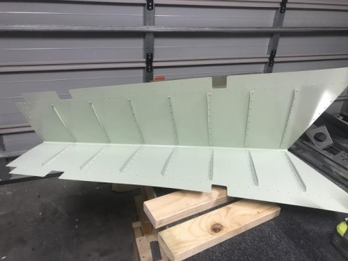

Brief Description:  Backriveting
Finished the back riveting on the elevators which was a bit of a learning curve with lots of rivet removal in the process. Two rivets I removed and reset seem to have compromised the hole and won't reset nicely so I have ordered from Oops Rivetsfrom Aircraft Spruce and have put the skin aside till they arrive. I guess I'll be need these a few times on the build and they are quite a clever idea to have the same shop head as a 3 but with the stem of a 4...will see how I do on them.
