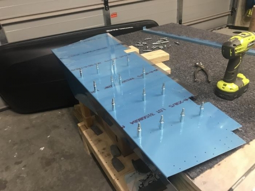

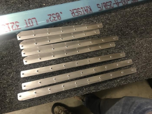

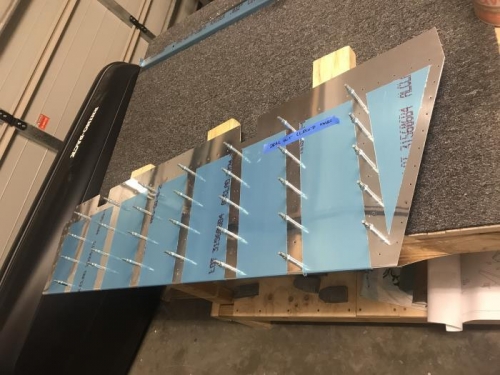

More work on the right elevator today. Attached the top side L angles and drilled them out to size and then deburred the L angles and then scotchbrited them. Thereafter dimpled the holes on the stiffeners.
Started on the bottom side stiffeners but left it for the evening. Removed the bluing from the inside and rivet lines on the outside.
