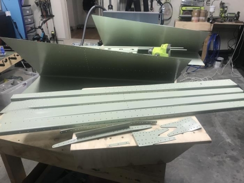

Date:  4-12-2020
Number of Hours:  5.00
Brief Description:  Spray painting day
With all the parts deburred, sanded edges and scotchbrited plus dimpled it was time to degrease and clean the parts for spraying. For the spraying I used a PPG Protec 2k primer with a hardener and reducer in the ratio of 4 : 1 : 10%.
Spraying took a long time as it took long for the paint to dry. Had a few runs and areas that I will have to touch up tomorrow but generally went quite well and happy with the colour. More experience spraying needed.
