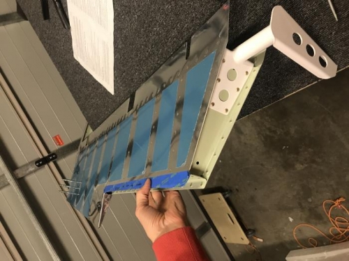

Brief Description:  Bending skin and final assembly
Exciting bit of progress, after not screwing up the bend in the left elevator skin it was time to RTV ups the stiffeners and get straight into buttoning up the elevator skin onto the skeleton. All went pretty well with only one flush rivet that I need to drill out.
The area in blue tape was to remind me not to rivet this section closed as this only gets buttoned up when the trie tab hinge is installed which is a few steps away as I believe that you have to make this part first. A couple of flush rivets still to be set with the mushroom head rivet snap and thin bucking bar as they were too tight to fit the squeezer.
