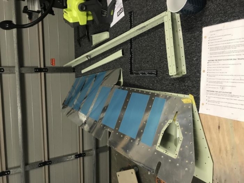

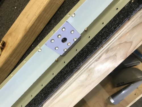

Sure a bit of clean up in the garage and bringing jobs together. I replaced one smileyed rivet in the left elevator's spa which went fine and also notice a couple of slightly underdriven others which I corrected.

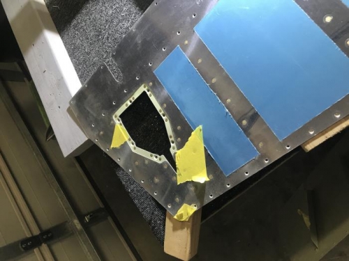

Also replaced three flush rivets on the trim servo motor reinforcement piece which I managed to smudge with the squeezer when I should have been back riveting. Also folded the trailing edge of the elevator skin and read ahead for some of the next stages.
