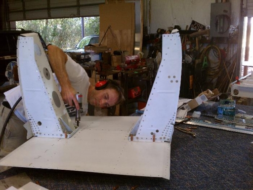

Borrowed Jim Kubik's 3x rivet gun and right away realized I wanted one. Also borrowed another offet 1/8 rivet set and was able to finish the fuselage floor riveting of the intercostal and floor ribs.

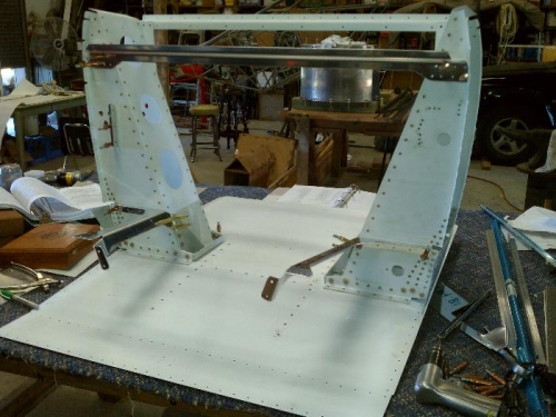

Finished tightening the bolts on the LG boxes and riveted them to the forward fuselage floor.
