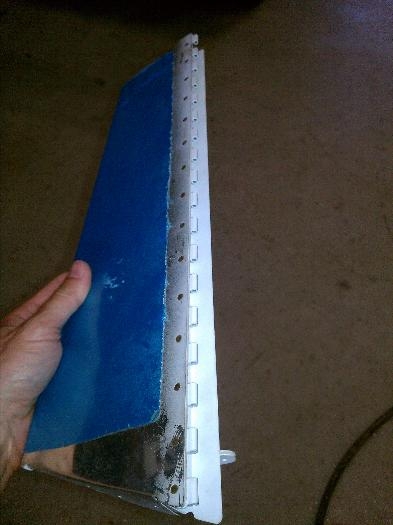

Match drilled, deburred, countersunk, primed, and riveted the half of the piano hinge that attaches to the left elevator. Brushed on the primer to keep from having the clean the gun for just one part.
Completed riveting the trim tab itself.
