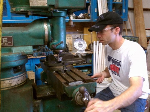

Trimmed the E-714 counterweights with the millling machine. Very nice piece of equipment.

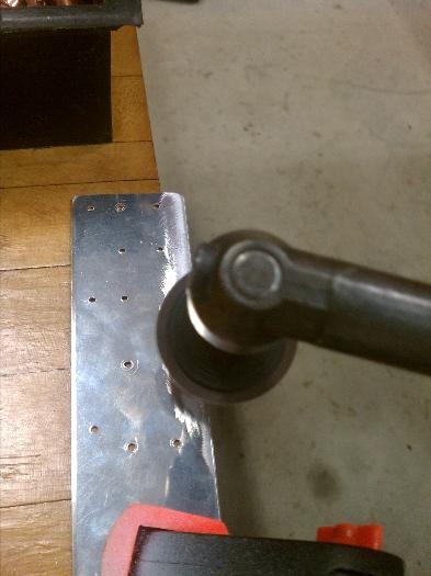

Using pneumatic sander to bevel counterweight skins
Milling machine to trim counterweights
