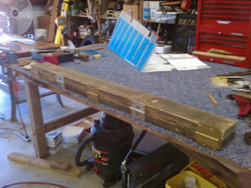

Built a bending brake out of 2x6 and spare door hinges. Made bends on flight control skins. Was nervous about it, but it turned out to nothing more than pressing on the board with my body weight

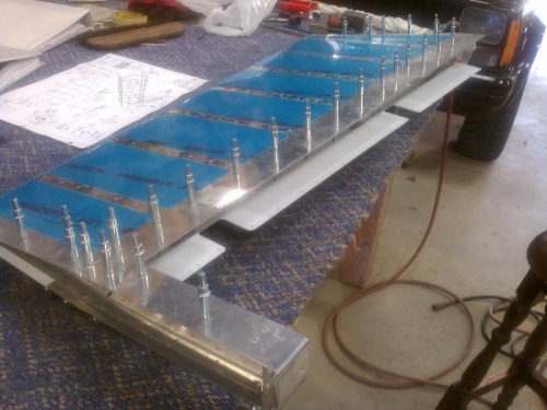

Built up the rudder and elevators and match/finish drilled the skins and skeleton. Ended up countersinking too far on the trim spar and might need to buy another one from the factory. Not sure how it happened, as I was using a microstop, but I'll look into tomorrow morning. Either way, feeling encouraged about how things are falling into place on the tail.
