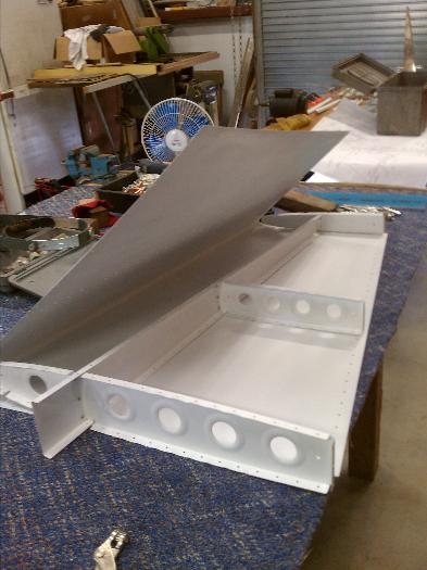

Completed the vertical stabilizer. Realized I had forgetten to dimple the spars and used a squeezer to go back over them. Made is necessary to restraighten flanges in a few places, but a pair of pliers fixed them beautifully.

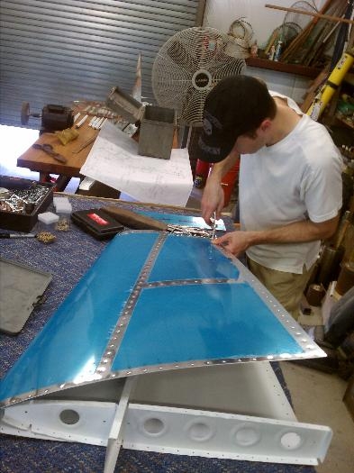

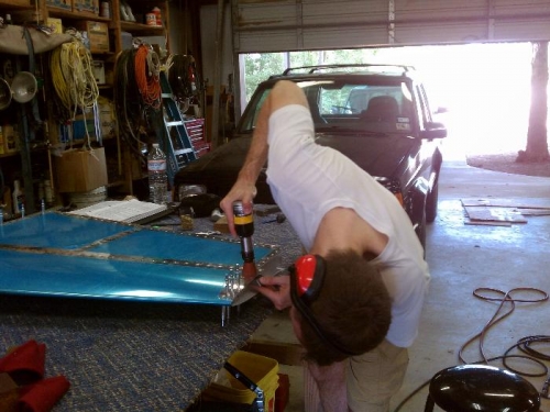

Riveted the stiffeners on the rudder and elevator skins. Back riveting very easy and quick after spending the time to set everything up. Using rivet tape, works well.
