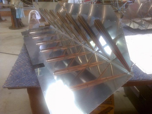

Clecoed and drilled stiffeners to both elevators. Found a few edges that still needed finishing. Still need to debur holes.
Etched and primes all vertical stabilizer components. Did not dilute primer and found it worked well.

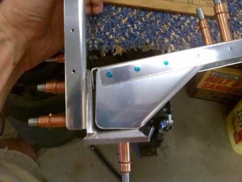

Began skeleton of rudder.

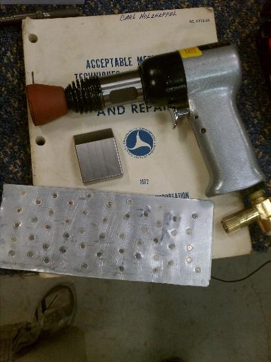

Bucked 50 rivets for practice, about a third of them back-driven. Need to have scrap examined by John Bolding.
