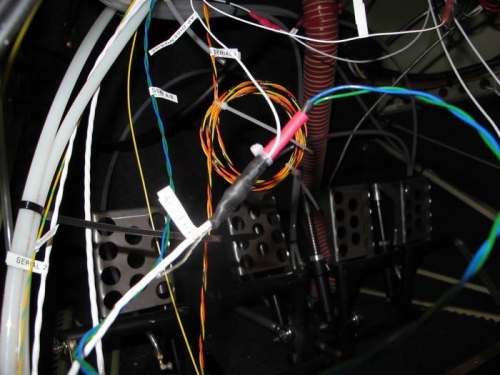

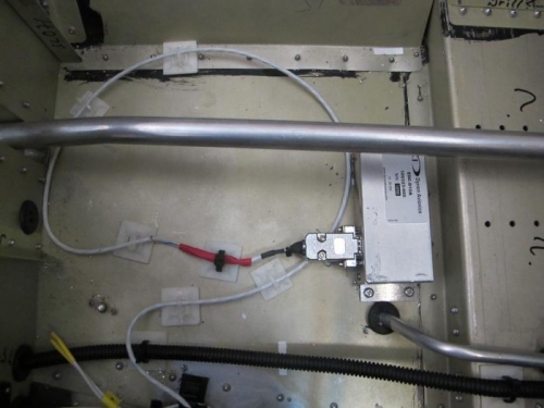

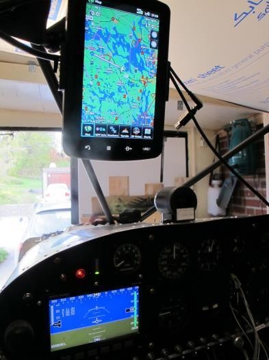

All nonelectronic instruments are in place mounted on the instrument panel. The EFIS, remote electronic compas and GPS are installed and most wiring are done incl wiring for future autopilot. The GPS was much larger and heavier than I expected and it took some time before I could find a place for it. Still to do is to get the EFIS to recognise the GPS signalin and to install the radio and the transponder (not yet delivered).
EFIS & GPS
EFIS & GPS
Remote compas
Remote compas
EFIS & GPS communication
