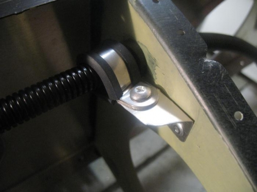

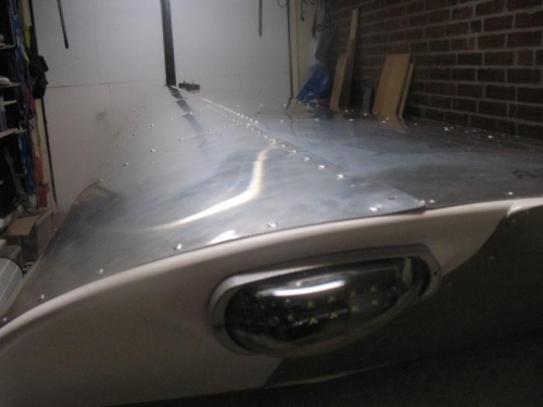

Like the right strobe the left strobe wire was run through rib no 1 and front ribs no 2-8 and attached to the ribs with clamps and a piece of Al rivetted to the rib. The strobe was attached to the plastic tip through three anchor nuts rivetted to the tip. Three ss 6-32 countersunk screws ( MS24693C27) kept the strobe in place.
Attachment of strobe wire

Strobe in place
Strobe in place
